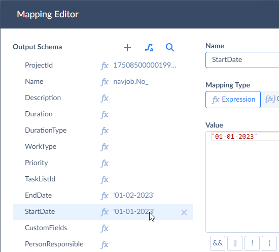

I have an action to insert a task. If I input values to just the ProjectId and name fields, it works. Where I am having issues is in two places:

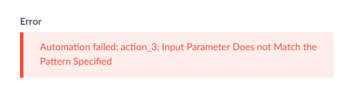

1. Start Date and End Date fields. No matter what combination of date format I try (maybe 10-15 or more so far), I get an error "Input Parameter Does not Match the Pattern Specified" when inserting the task.
I have queried these fields + tried copy-pasting existing values from the database as test data. It still throws the same error.

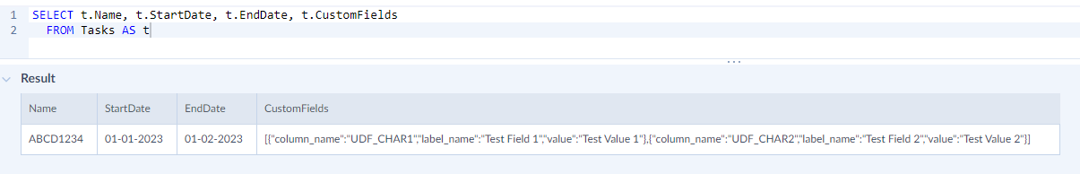

2. Custom Fields seem to be stored in an array containing a column name, label name and value for each field. You can see a sample in the screenshot of the query above.
- [{"column_name":"UDF_CHAR1","label_name":"Test Field 1","value":"Test Value 1"},{"column_name":"UDF_CHAR2","label_name":"Test Field 2","value":"Test Value 2"}]
