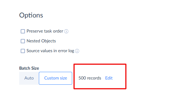

The error "Internal error encountered. Error code: 500" is returned by the Google Sheets API and is typically caused by processing a large volume of data.
To resolve this issue, we recommend adjusting the Batch Size value in your integration. For example, you can set it to 500:
You may also try other values to find the optimal setting for your scenario.
After updating the Batch Size value, please run your integration again and check if the issue is resolved.
