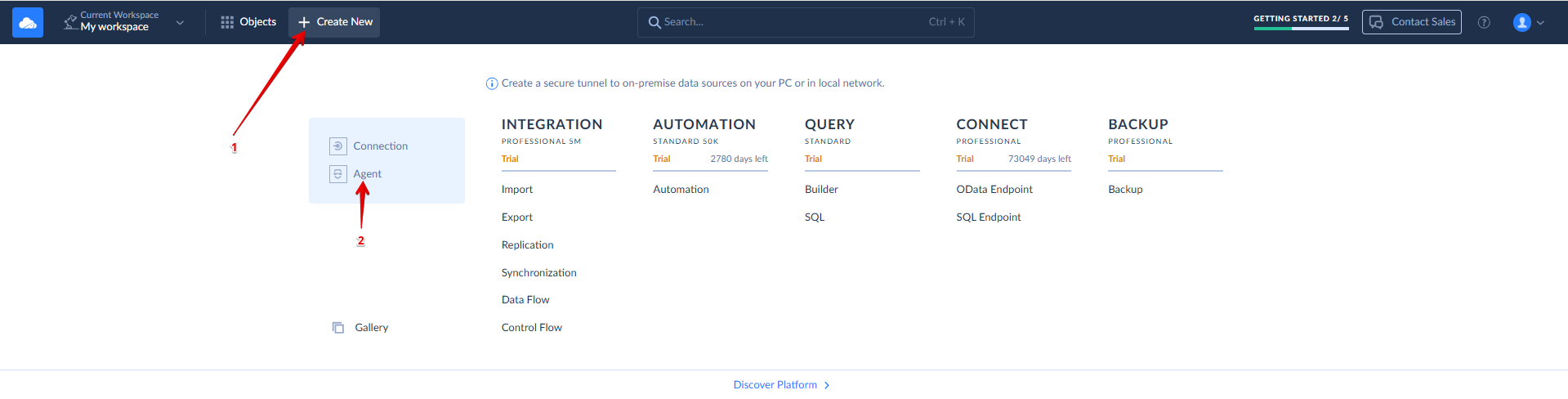

If you need to run agents in multiple workspaces, you do not need to install the agent again on your computer:
1) Simply create a new agent in the additional workspace:

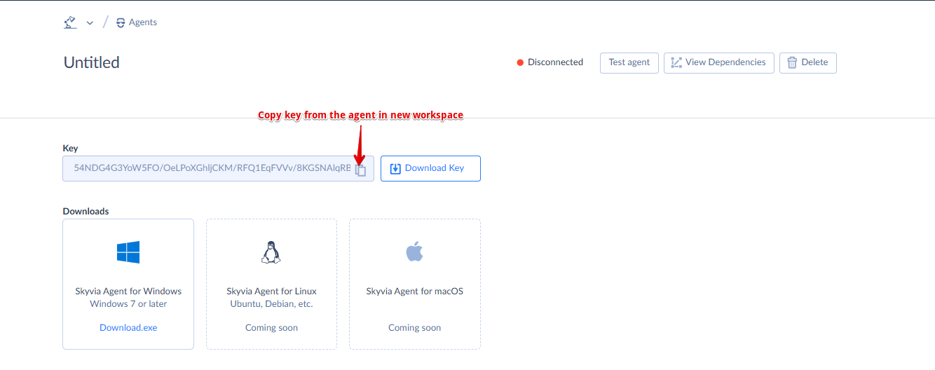

2) Copy the key from the agent in the new workspace:

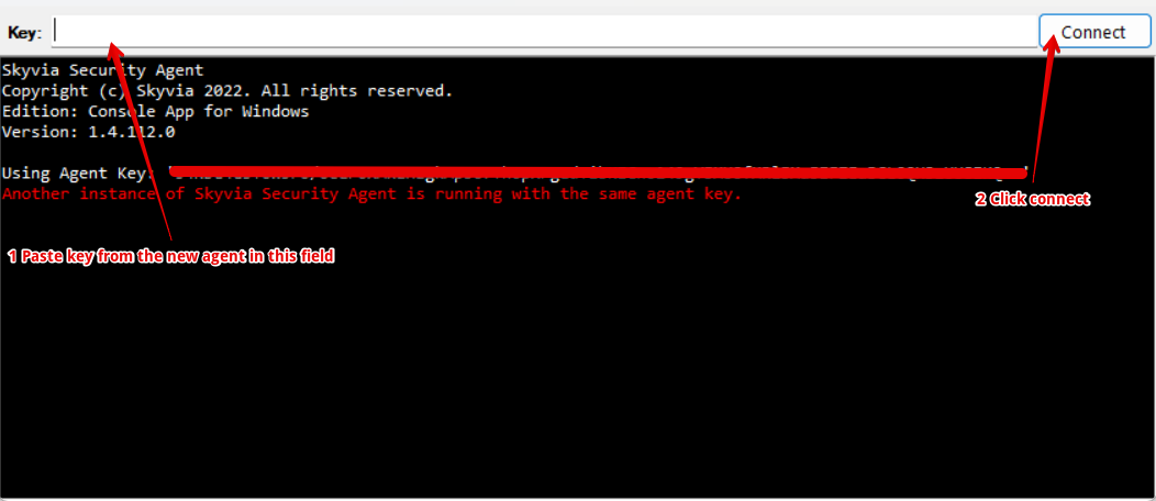

3) Paste the key from the new agent to the Key field and click Connect:
The agent will then connect to this workspace, and you can use it in your connections.
